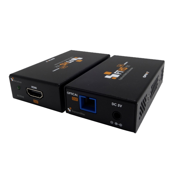

This unique fiber optical transceiver let your PC, digital UHD monitor extend up to
200 meter(656ft) away from host based on HDMI standard without signal degradation
by UHD (3840x2160 or 4096x2160 @60Hz) resolution.
▪ Compatible with HDMI standard V2.0a
▪ Main-link video signal / DDC data and Hot Plug Detection signal is transmitted by-
1 channel multimode optical fiber
▪ SCDC(Status and Control Data Channel) compliant
▪ HDCP 2.2 compliant
※ Does not support CEC and HEAC.

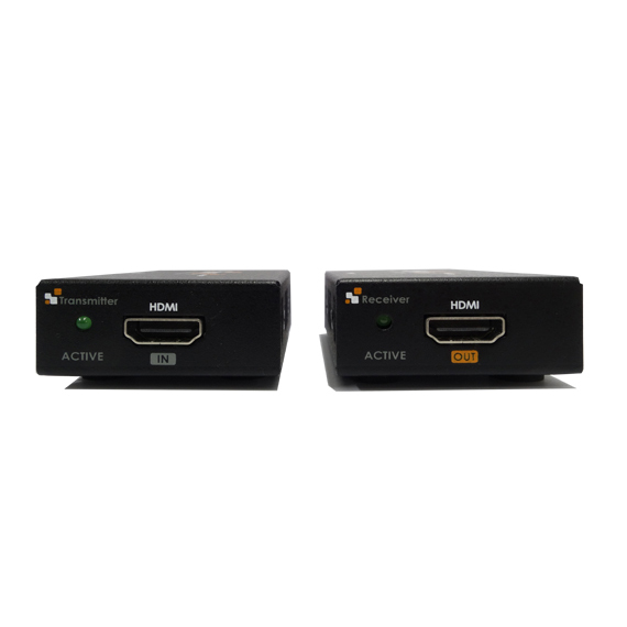

▪ Input and Output Signal : HDMI 2.0 Standard
▪ Video Bandwidth : 18Gbps
▪ Optical Connector : SC Connector
▪ Electrical Connector : HDMI type A Connector (Female)
▪ Maximum Supporting Resolution : UHD(3840x2160 / 4096x2160@60Hz)
▪ Transmission distance : 200 meter (656 ft)
• Power Consumption (transmitter) : 3.05W (Typ)
• Power Consumption (receiver) : 2.85W (Typ)
• Power Adapter 2ea
• 1.0M HDMI cable 2ea
