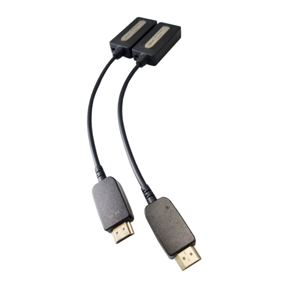

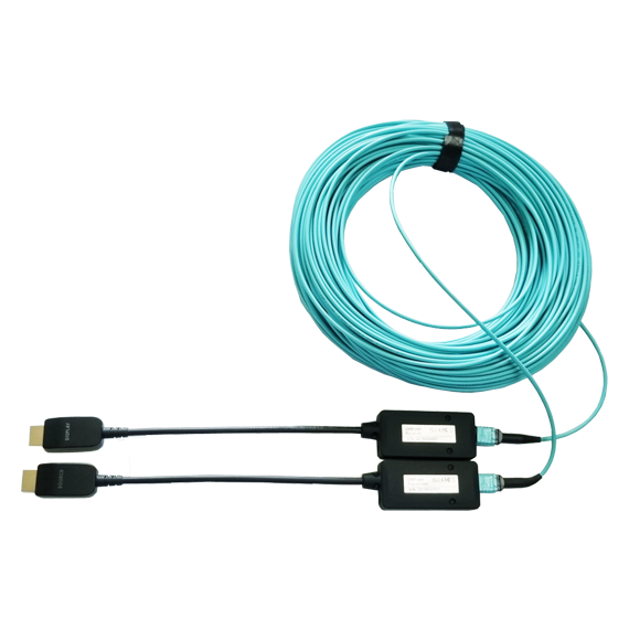

OMP-HM, it is HMDI 2.1 optical fiber extender which complies with HDMI 2.1 standard and supports real 4K/8K UHD (4096x2160, 7680x4320) resolution. It enables to transmit high quality 4K/8K resolution up to 100 meter (330ft) using by optical multi-mode fiber(with MPO type connector) without any video signal loss.
• High Speed and long distance transmission by optical fiber

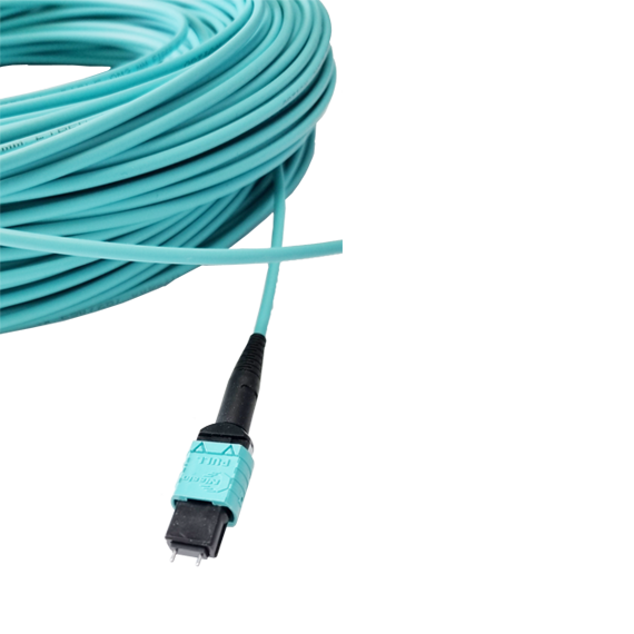

• Supports OM3 (or OM4) fiber with 8core MPO type connector

▪ Dimension : 300L x 31W x 16H (mm)
▪ Electrical Connector : HDMI type A Connector (Female)

▪ Transmission distance : 100 meter (330 ft)
▪ Power Consumption (transmitter) : 0.75W (Typ)
▪ Power Consumption (receiver) : 0.95W (Typ)
