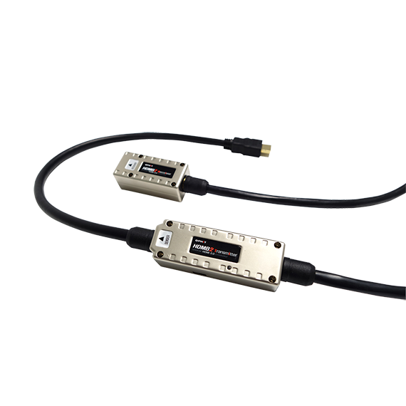

HDMI2.0 Optic Fiber Cable
This fiber optic cable system let your HDMI compliant display device extend up to 40 meters (131.2 fit)
away from host based on HDMI standard without signal degradation by 4K UHD (3840x2160 @ 60Hz)
and 3D FHD(1920x1080@60Hz) resolution.
▪ Compatible with digital video and audio of HDMI-V2.0 standard
▪ The use of standard HDMI source-sink connector
▪ High Bandwidth Cable Assembly (up to 6Gbps Data Rate / Ch)
▪ E-EDID and Hot Plug channels are transmitted by copper line
▪ Supports HDCP by DDC channel
▪ CEC compliant
▪ SCDC(Scrambling) function is support
▪ Power operation LED installed
▪ HEAC is not support
▪ External power supply is used as the default.
▪ HDMI-gender or signal conversion equipment does not guarantee
• Input and Output Signal : TMDS Signal HDMI 2.0 standard
• Video Bandwidth : 18Gbps
• Size
 - Transmitter : 74W x 24D x 19H (mm)
 - Receiver : 54W x 24D x 19H (mm)
• Optic Fiber : 50/125㎛ Multi-mode glass-fiber
  - Transmitter : HDMI type A Plug(Male)
  - Receiver : HDMI type A Plug(Female)
• Maximum Supporting Resolution : 4K UHD (3840x2160 @ 60Hz) and 3D FHD(1920x1080@60Hz)
• Transmission distance : 40meter (131.2ft)
• Power Consumption (transmitter) : 1.65W (Typ)
• Power Consumption (receiver) : 2.2W (Typ)
• HDMB2 cable
• power adapter 1ea
• HDMI TO HDMI Cable 1ea
• HDMB2-A010 : HDMB2 Cable 10 meters
• HDMB2-A015 : HDMB2 Cable 15 meters
• HDMB2-A020 : HDMB2 Cable 20 meters
• HDMB2-A025 : HDMB2 Cable 25 meters
• HDMB2-A030 : HDMB2 Cable 30 meters
• HDMB2-A040 : HDMB2 Cable 40 meters
