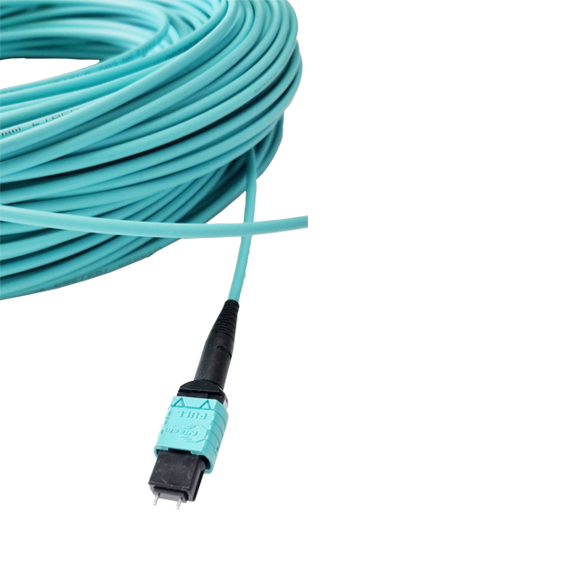

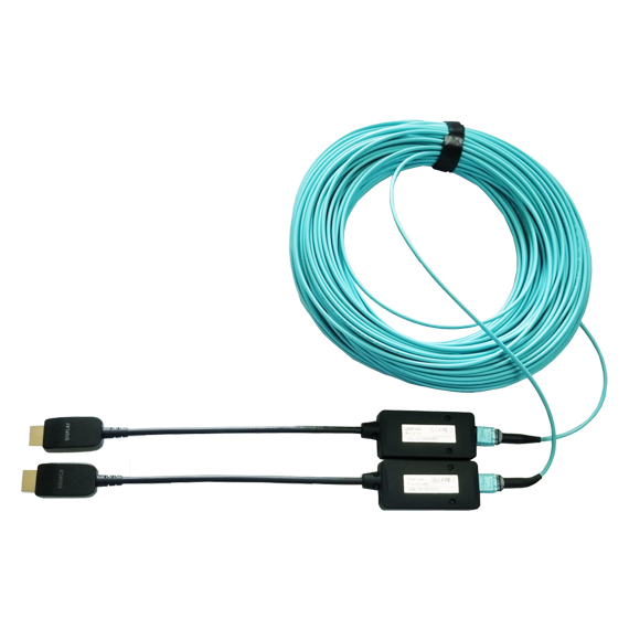

OMP-HM, it is HMDI 2.1 optical fiber extender which complies with HDMI 2.1 standard and supports real 4K/8K UHD (4096x2160, 7680x4320) resolution. It enables to transmit high quality 4K/8K resolution up to 100 meter (330ft) using by optical multi-mode fiber(with MPO type connector) without any video signal loss.
• High Speed and long distance transmission by optical fiber
• Compatible with HDMI standard v2.1
• Supports OM3 (or OM4) fiber with 8core MPO type connector
• I2C data and Hot Plug Detection signal is transmitted by optical fiber
• CEC control, EDID, and HDCP
• EMI & Safety : CE, FCC

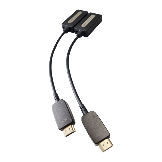

▪ Input and Output Signal : HDMI v2.1 Standard
▪ Video Bandwidth : 48Gbps
• Dimension : 300L x 31W x 16H (mm)
▪ Electrical Connector : HDMI type A Connector (Female)
7680x4320 @60Hz)
▪ Transmission distance : 100 meter (330 ft)
• Power Consumption (transmitter) : 0.75W (Typ)
• Power Consumption (receiver) : 0.95W (Typ)
