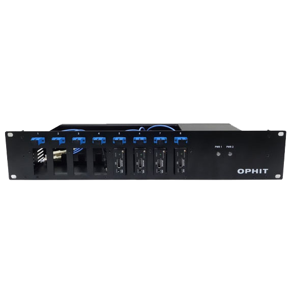

The 19RM-001 is a 19-inch rack mounting structure that offers the flexibility to mount up to eight(8) 4K Optical Extender, to be installed at the same time.
4K Optical Extenders mounted on the 19RM-001 can be simultaneously powered.
Also, with two built-in AC/DC power supplies, can reliably supply DC power to 4K Optical Extenders, even if one of them fails.
Up to OPHIT’s eight 4K Optical Extender (FTDS or FTHS) can be installed, and it is possible to
mix and match the transmitter / receiver according to the user's use.
The 19RM-001 can be easily mounted and fixed to a commonly used 19 inch rack using the screw hole on the front part.
▪ 19 inches 2U size (Four screw holes on the front, can be mounted on commercial 19 inch rack)
▪ Dual AC/DC power supply (power sharing)
▪ Up to 8 OPHIT's 4K Optical Extender (FTDS, FTHS) can be installed.
▪ 8 SC type optical connectors on the front. (OM3, Up to 200m)
▪ Power state indicate LED x 2 ( Each per AC/DC power supply)
▪ Eight DC cables that can be removed / installed are installed inside.
▪ Eight OM3 cables (22cm) that can be removed / installed are installed inside.

 - Front : SC Type Jack x 8, LED x 2, Screw hole x 4 

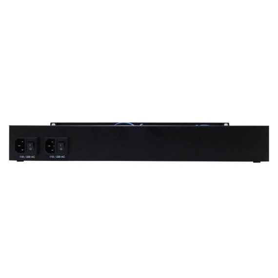

 - Back : AC Jack x 2
 - Inside : DC Jack x 8, SC Type Jack x 8
