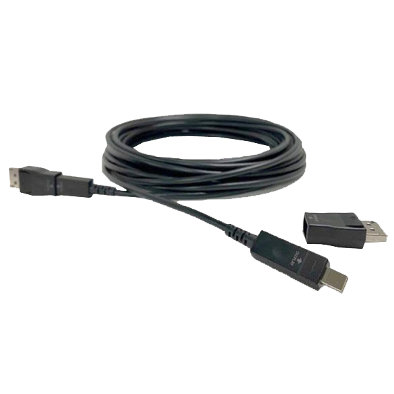

FTAD2 is detachable AOC (Active Optical Cable) for DisplayPort standard.
The FTAD2 consists of a transmitting part and a receiving part, both of which are connected by a hybrid cable (Optical cable + electric cable). The FTAD’s transmitter is connected to the Display Port source device, and the receiver is connected to the DisplayPort sink device. The mini-Displayport connector also be used by connecting each source and sink device.
With FTAD2, Video/audio signals can be transmitted up to 100m when a system using DisplayPort standard is used. It is possible to transmit the DisplayPort specification signal of the UHD bandwidth without loss.
