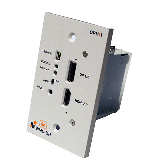

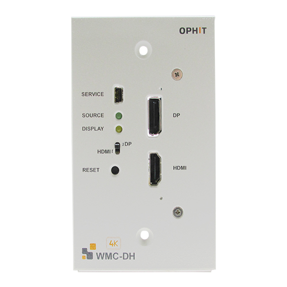

 Ophit’s WMC-DH is an MPO/MTP-type wall plate video signal converter with an option to manually select the HDMI (2.0) or DisplayPort (1.2) input switch, transmitting high-speed
data through HDMI (2.0) TMDS-compatible optical output signal, producing high resolution up to 4K (4096 x 2160) @60Hz without signal degradation.

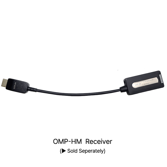

The newly launched wall plate video signal converter connects to the OMP-HM-R (Receiver) via MPO-type optical cable for up to 100m (330ft) of uncompressed data transmission.
Specifically designed to be mounted in a single gang enclosure, the WMC-DH provides zero latency and offers high-speed video signal transmission solutions for Medical system or Broadcast, Control system etc.
•       Supports the HDMI 2.0 standard and DisplayPort 1.2 standards
•       Equipped with two LEDs to indicate the status of input and output
•       Equipped with one push button switch to reset the system
•       Transmits converted optical signal using one MPO type optical cable
•       Designed to mount in a single gang sized slot
