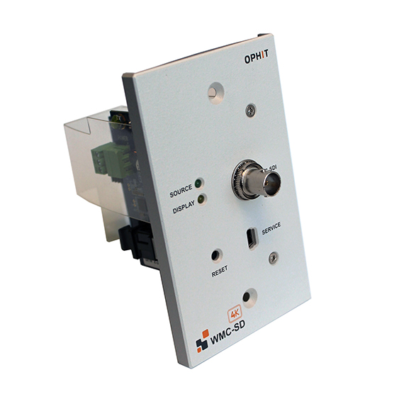

 Ophit’s WMC-SD is an MPO/MTP-type wall plate video signal converter that converts 12G-SDI to HDMI 2.0 TMDS-compatible optical signals, delivering maximum resolution up to 4K (4096 x 2160) @60Hz without signal degradation.

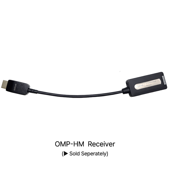

The newly launched wall plate video signal converter connects to the OMP-HM-R (Receiver) via MPO-type optical cable for up to 100m (330ft) of uncompressed data transmission.
Specifically designed to be mounted in a single gang enclosure, the WMC-SD offers high-speed video signal transmission solutions for Medical system or Broadcast, Control system etc.
       Supports the HDMI 2.0 standard
       Supports SDI interface standards from HD-SDI to 12G-SDI

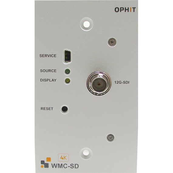

       Equipped with two LEDs to indicate the status of input and output
       Equipped with one push button switch to reset the system
       Transmits converted optical signal using one MPO type optical cable
       Designed to mount in a single gang sized slot
