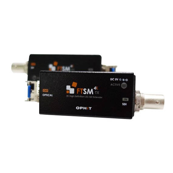

FTSM transmits very high speed 12G-SDI signals over long distances through 1Ch optical fiber cable.(LC connector/single mode fiber). It can transmit a maximum 4K Ultra HD resolution(4K@60Hz) and up to 5Km .
▪ Mini type 12G-SDI Ultra HD Video signal long distance optical extender
▪ Supports video pathological patterns for SD-SDI, HD-SDI, 3G-SDI, 6G-SDI and 12G SDI
▪ Highest video signal with very low Latency
▪ Standalone small Box type
• Video Bandwidth : 11.88Gbps
• Dimension : 59W x 27.3D x 27H (mm)
• Optical Connector : LC Connector
• Using electrical connector
- Transmitter • Input : SDI (BNC)
• Output : Optical (LC)
- Receiver : • Input : Optical (LC)
• Output : SDI (BNC)
• Applied Fiber : 1310nm 1-Ch Optical single-mode fiber
• Maximum Supporting Resolution : 4K (3840x2160@60Hz)
• Transmission distance : 5000meter (16,404 ft)
• Power Consumption : 1.5W (Typ)
