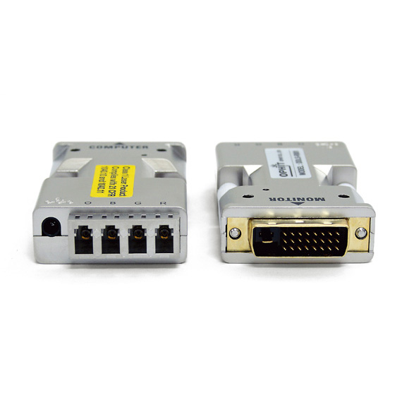

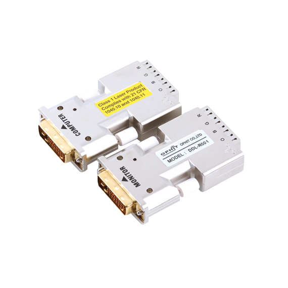

OPHIT’s DDL with fiber optical cable system let your digital flat panel display extend up to 1,000meters (3,300 feet) away from host by TMDS digital signal transmission.
• High Speed and long distance transmission by 4 channel LC type multi-mode optical fiber
• R G, B, Clock signal is transmitted seperately over optical fiber
• Support up to WUXGA (1920 x 1200) and 1080p (1920 x 1080)
• Self detecting function for EDID information
• EMC & Safety : CE, UL, FCC

• Connector (transmitter) :DVI-D (male), LC connector (female)
• Connector (receiver) : DVI-D (male), LC connector (female)
• Optic fiber : 4ch / Multi-mode(50/125μm)

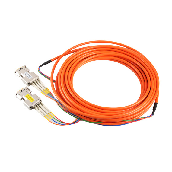

• DDL-M : Transmitter, Receiver and 1 x power adapter
• DDL-AXXX : Transmitter, Receiver and 1 x power adapter + Multi-mode 4ch(LC connector) optic fiber XXX meters
