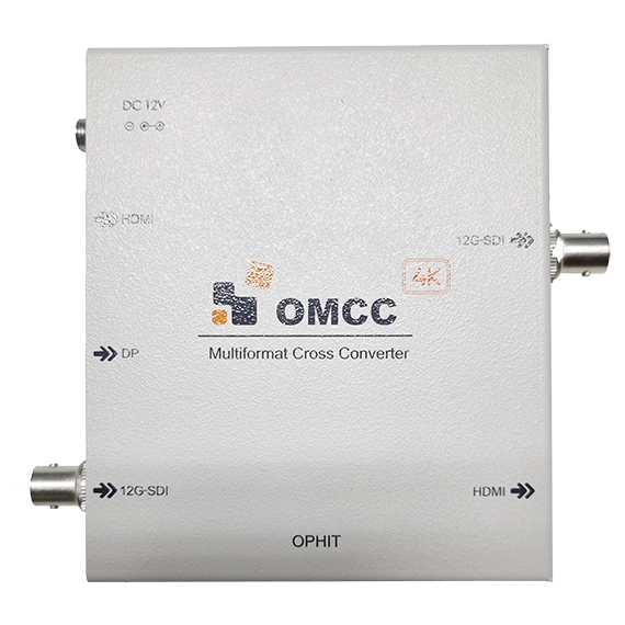

Ophit's OMCC is a lightweight and compact 4K multi-format cross converter. It converts HDMI or DisplayPort into SDI 12G, 6G, and 3G signals, transmitting high-definition video through the SDI bypass port connection without compromising video signal quality.
The OMCC also converts DisplayPort and SDI signals into HDMI, producing 4K@60Hz resolution for vibrant images. Moreover, the OMCC can select the input video format using the tactile (push-button) switch and the output video format using the SDI (right) / HDMI (left) switch. This feature is compatible with professional broadcast equipment, allowing simple integration into existing installations.
       Maximum resolution up to 4K@60Hz
       Convert HDMI or DisplayPort to SDI format in 12G, 6G, 3G, and HD
       DisplayPort input and SDI input can be converted to HDMI output
       Supports SDI input / output Level A
       Select the input video format using the tactile (push-button) switch
       Select the output video format using the SDI (right) / HDMI (left) switch
       Supports firmware updates via USB port
       12G-SDI output automatically detects the input video rate and matches
the SDI output with YCbCr 4:2:2-10bit video rate
