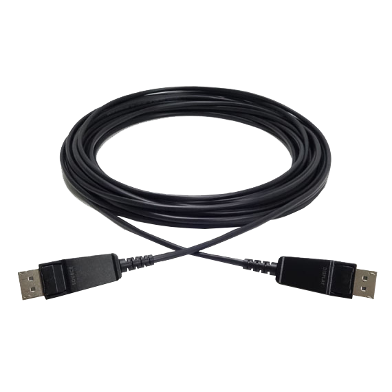

FTAD is AOC (Active Optical Cable) for DisplayPort standard.
The FTAD consists of a transmitting part and a receiving part, both of which are connected
by a hybrid cable (Optical cable + electric cable). The FTAD’s transmitter is connected to the Display Port source device, and the receiver is connected to the DisplayPort sink device. With FTAD, Video/audio signals can be transmitted up to 100m when a system using Display
Port standard is used. It is possible to transmit the DisplayPort specification signal of the
UHD bandwidth without loss.
▪ Input and Output Signal : DisplayPort 1.2a/1.4 Standard by VESA
▪ DPCD/HDCP compliant
▪ AUX and Hot Plug channels are transmitted by copper line
▪ Gender or signal conversion equipment does not guarantee
▪ Maximum transmission distance : 100m
▪ Connector : DisplayPort 20pin (Male)
▪ No external power supply required
• Connector (transmitter) : DisplayPort 20pin (male)
• Connector (receiver) : DisplayPort 20pin (male)
• Applied Fiber : 50/125 ㎛ Multi-mode glass-fiber
• Video Bandwidth : Per lane, 5.4Gbps(HBR2)/8.1Gbps(HBR3)
   - 7680X4320@60Hz / 100M (328ft)
• Power Consumption (transmitter) : 0.122W (Typ)
• Power Consumption (receiver) : 0.264W (Typ)
• Module Dimensions
   -53.8(W) x 19.9(D) x 11.9(H)mm
• FTAD
• FTAD-AXXX : FTAD Cable XXX meters (Max. 100m)
