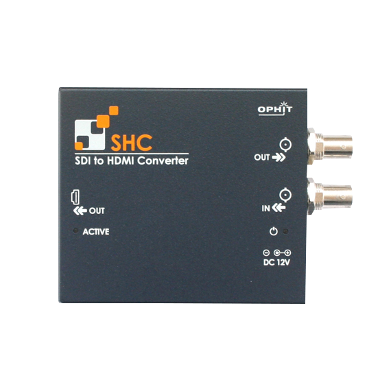

SDI to HDMI 컨버터
OPHIT's SHC is perfect solution for converting SDI singnal to HDMI signal. It enables SDI compliant device to be connected to display with HDMI port.
• Converts SDI signal to HDMI signal
• Input : 1 x SDI / Output : 1 x SDI, 1 x HDMI
• Compliant with HDMI v1.3, HDCP v1.1 and DVI v1.1 standards
• Serial digital video transmitter for HD video :
- SD 480i @ 60Hz
- HD 720p @ 50, 60Hz
- HD 1080i @ 50, 60Hz
- HD 1080p @ 24, 25, 30, 50 and 60Hz
• Support one SDI output for cascade
• LED indicator for power and signal detection monitoring
• Input port
  - SDI signal   SMPTE 259M-C (270Mbps)
                     SMPTE 292M (1.485, 1.485 / 1.001 Gbps)
                     SMPTE 424M (2.970, 2.970 / 1.001Gbps)
 • Output port
  - HDMI signal (480i, 720p, 1080i, 1080p)

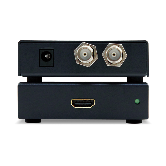

  - Input : 75Ω BNC (female)
  - Output : HDMI A type (female) / 75Ω BNC (female)
  - Power : DC-Jack 2.1pie
  - Dimension : 100W x 85D x 25H (mm)
  - Weight : 250g
  - Power : 100 ~ 240V with DC 12V, 1A
  - Power Comsumption : 2.4W (max)
