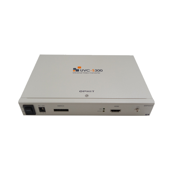

This Universal Video Converter (Model: UVC-S300) is powerful Multi-Format Video input/output Converter which is able to convert Digital to Analog. This unit has digital HDMI port as input formats and Composite (RCA & BNC) / S-Video / D-SUB / DVI as output formats. The input video signal (HDMI) is converted 5(five) output formats as analog Composite (RCA and BNC) / S-Video / D-SUB and 1(one) digital DVI output. The unit has a unique function as cropping which is available in the S-Video /composite output formats. The unit is designed with a stringent safety requirements such as the medical environment and other similarly restriction location.

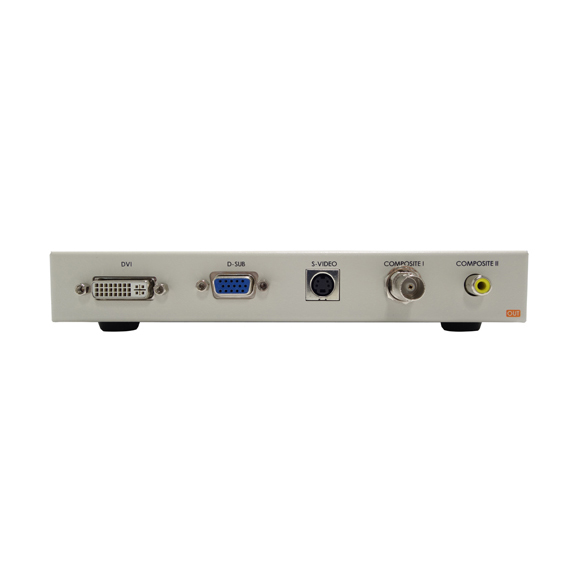

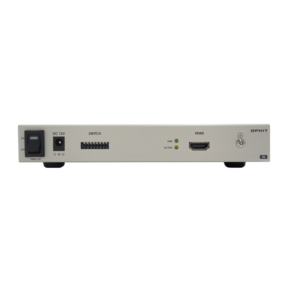

• Connector :
- Input : HDMI(female) x 1
- Output : DVI 24Pin(female) x 1, D-sub(female) x 1
S-video(female) x 1, Composite(BNC x 1, RCA x 1)
• Supporting Resolution
- Input : 1024x768@50/60Hz
1280x1024@50/60Hz
1920x1080@50/60Hz
- Output : DVI : 1024x768@50/60Hz, 1280x1024@50/60Hz, 1920x1080@50/60Hz (Convert and Bypass)
D-Sub: 1024x768@50/60Hz, 1280x1024@50/60Hz, 1920x1080@50/60Hz (Convert and Bypass)
S-video : NTSC-M or PAL-BGHI (Crop Image)
